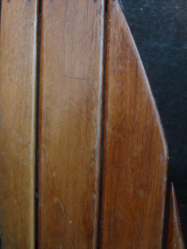

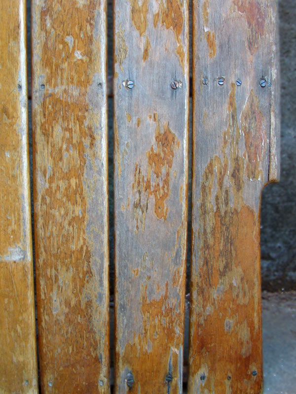

Here are some pictures of the "before state":
Floorboards in need of refinishing
Some graying due to weathering, some cracking, assorted collection of fasteners.
The original varnish seems to either have had a reddish brown tint, or it weathered that way; a later layer is more amber, and the top layer was almost clear. Where the original layer is intact, all the other layers continued to stick, with perhaps a little peeling around scratches, otherwise, despite treating the bare wood, none of the additional layers stuck to the wood.

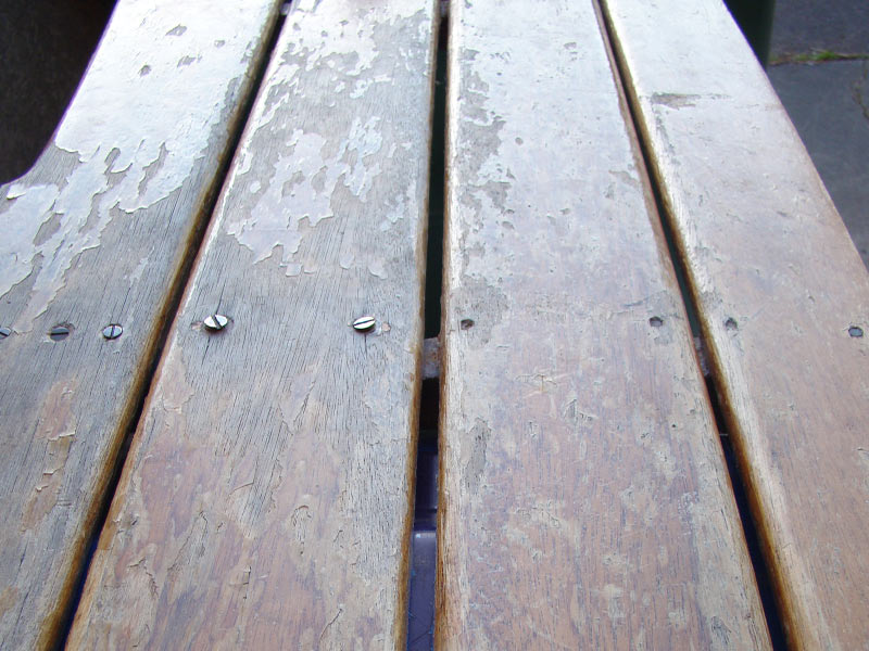

Fasterners stick out:
Fasteners stick out

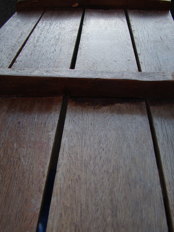

Forward section, in the shade of the cuddy and not stepped on:
Forward section - protected.
Underside: all coatings in perfect condition. No UV degradation and no scraping. But the wood was never fully planed/sanded, so it looks rough.
Underside

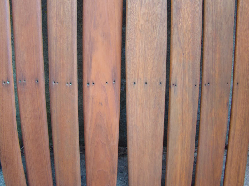

Postby GreenLake » Mon Mar 09, 2015 1:15 am
Here's an interim view. Boards are sanded to bare wood and treated with a stain ("maple"). The result almost looks like teak, but it does a good job of evening out the color differences -- however, even then, the individual slats are not perfectly matched, and curiously, their weights are very different. All had weeks of drying in the furnace room, so it's probably not different moisture content.
Main (cockpit) section floor boards, after staining with "maple".
Note how despite the stain there's some variation in color among slats, but how the stain helps blend in discoloration from weathering near the fasteners.
