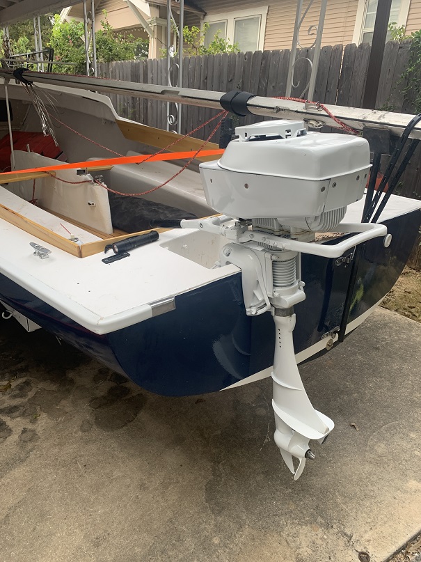

Postby Brianl289 » Wed Nov 17, 2021 11:23 am
well we finally got the boat on the water! I went out with the previous owner of the boat who is a good friend of mine and we cruised around for the afternoon and just took it easy. Was hardly any wind. Still have some adjustments to make to some rigging as you can see the jib in the photo wasn't tight. We ended up figuring it out later but it wasn't a very windy day so it wasn't a big deal. Need to modify the main sheet rigging too but it's all good. The good news is the boat was completely dry inside and we didn't have any part failures or problems! We ended up putting 7 adults and 1 baby in there comfortably and the boat did great. I don't think I have a photo of it at the moment but I did end up installing a small bilge pump/battery setup in the transom just incase we took on water for any reason. The lake we were on doesn't allow gas engines so we had a couple paddles and it worked out just fine for getting back to the dock. The next day I was on craigslist and scored this super cool 67 Clinton-Sears 3.5hp motor for when we go to a big lake. It weighs in at about 36lbs and has a 2 gal aux tank. Grabbed it for $200 which I thought was a steal, so I'm gonna paint it to match the boat as well. Overall a great day and can't wait to get her back on the water.

Postby GreenLake » Wed Nov 17, 2021 2:10 pm
Nice to see her on the water. When it's flat water and not that much wind, as you discovered, the DS can be sailed with quite a few people.
The DS is a small boat, so I would tend to advise to go slow with adding any permanent installations like bilge pumps. If it's just about water you may be taking on while underway, a manual system might be more suitable than something that requires you have electricity when you need it.
For leaving the boat unattended, like on a mooring, the situation may be different. Or, if you want to prepare for a scenario where you continue to take in water while single handing, but don't have a hand free to bail occasionally.
As for the motor, I'd recommend you practice sailing your DS in and out of any and all situations (other than dead calm), so you're not stuck if you run into any issues. Including docking (or anchoring/mooring) under sail. (My experiences sailing on other DSs that had combustion engines are rather mixed when it comes to that).
