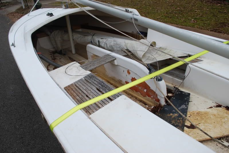

Yesterday I made the 6 hour trip to Augusta and picked up our new for us daysailer. She's an 85 Spindrift and, as you can see, she needs some work. This is my first boat and there will be lots to learn but I'm excited about the journey!
She seems to have everything there for my wife, small daughter and me to get out sailing this spring. And I was really pleased this morning that a few sprays of greased lightning should be enough to get off most of the stains. I know that will especially make my wife happy!
I think the first thing I'll do over the winter, after a general cleaning, is to remove the woodwork and work on painting the cockpit and inside cabin. Any suggestions?

First, congratulations - you bought a grand boat and there are lots of folks here to help. I bought my DS1 a few years ago and it was in much worse shape. It was a great joy for me to restore Truelove to her former glory.
THere is a lot of info on restoring the footboards and the coamings. Strip, sand, varnish. Take the footboards completely apart and mark the pieces!
As for the raw fiberglass surfaces, I used a latex. I called West Marine tech support and they recommended their boat interior latex. The MSDS sheet said it was basically a good quality exterior latex. Instead of paying West $30/qt I went to the local harware and bought Kilz primer and then a wquart of exterior latex. I sponged on a contrast color.
The latex has held up well.
You could also use an epoxy or even gel coat
As for the stains on the bottom, start with one of the nasty boat cleaners with oxalic acid. Use rubber gloves. After that go at with with polishing compound and a power buffer.

Your boat looks to be in generally good shape. Once you have the surfaces cleaned up you should consider a good buffing and wax job. Your hull may take some time as the waterline stain looks pretty bad. I have used C.L.R. on waterline stains with great results. After the cleanup, woodwork, and gear restoration, I would take an afternoon and go over the trailer for typical things like the wiring harness and greasing the ball coupler. I would definitely pull the wheels and hubs and repack the wheel bearings. Like GreenLake mentions reviewing the posts on this site will provide invaluable help. There is a great “search” feature provided. Brad

Consider using a pressure washer on the waterline stains, any mold, and the loose paint in the cockpit.
I did on my DS1 and had great results.

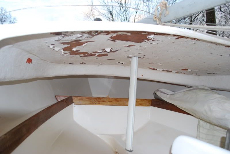

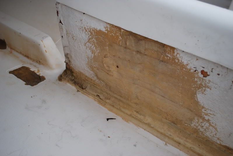

I've decided to focus my efforts on the interior underside of the cabin and the centerboard trunk. I'm new to fiberglass and it looks like there's been some repair work done on the trunk. There is, what looks like very solid tape all the way around where the trunk connects to the hull and again on the port side of the trunk. Can I sand and repaint these repairs or do they look substandard to you?
Also, would it just be awful to use spray can paint on the interior underside of the cabin? It seems like that area never gets any sun, or traffic and little water on it. I'm hoping to scrape away most of that old paint. After scraping, would a solvent be the next step to remove anything remaining or would palm sanding be a better choice?
I'm a real novice so I appreciate all of the great feedback!

The glass work on the cb locker could use some work. It may just be cosmetic, but consider going over it again with another layer of glass and then fairing it out again. For the later you could use marine bondo.
Pay particular attention to where the cb locker meets the hull. The seam should be solid. it looks like someone caulked it.
As for painting the cuddy, spray paintwould be more trouble than it is worth. It is an ennclosed space and the paint will get everywhere. It would be simpler to sand, prime and repaint with a foam roller.

The CB to hull joint can use being strengthened anyway. If you are adding a layer of glass (tape, I'd assume) then you can, and should, sand the existing stuff down to bare glass. You want to read West Marine's little handbook on fiberglass repair with epoxy first. Then you need to make sure that the glass comes to lie in a reasonably smooth curve, and some fairing material is useful. However, you probably don't want the only contact of the new glass to the hull go through a layer of Bondo, whether Marine quality or not.
The epoxy needs to be measured precisely and mixed well (and not too much). It needs to really wet the tape. You need to squeeze out the excess so the glass rests close to the seam and isn't separated by a layer of un-reinforced resin. Those are the biggies to watch out for.
By all means, try it out on something else first, to get the feel for how the material handles. Nail some pieces of wood together in 90 degree angle and try to tape the "seam".
To do your undersides, rest the boat upside down. Rolling paint should then be easy.
