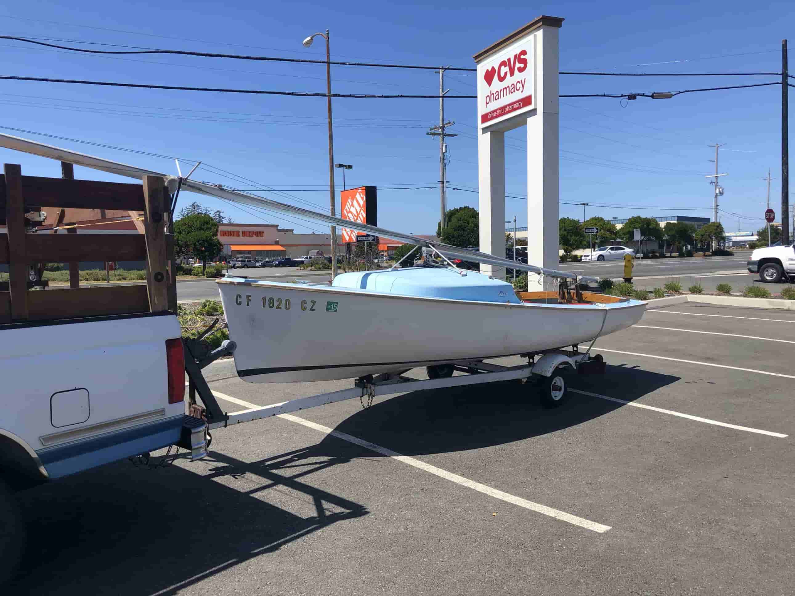

I just inherited Sloop du Jour (DS 2555) the family boat I grew up on on the 60’s-70s. I “rescued” her from my ex-brother-in-law’s driveway (yes, I have the paperwork) in the SF Bay Area and towed her, uneventfully, up to Kalama, WA where I live. She’s in remarkably good shape despite decades of neglect and outside livin and shouldn’t take much to put her yar again; masthead sheaves, spreader boots, maybe some new running rigging, woodwork and a good rubdown. I’ve already discovered D&R and found some great advice and discussion here.

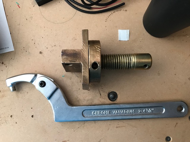

For the moment, I’m considering a mast tabernacle and found some good posts here regarding the process, but also found some disparity between what I saw in the photos and what I have. Also some differences in the dimensions. My mast step is a bronze post, with a coarse threaded ring that the mast rests on which is raised after stepping to tighten the standing rigging. I didn’t see one like it in any of the photos. The distance to the cuddy top is 30”. Every article I’ve seen on the process talks about 26” or so. Did that dimension change thru the years in a DS1?

-The screw and ring that your mast is sitting on is called a "Mast Jack." Should be a big chunk of bronze and yes - it's to tighten the rig all at one go, instead of using separate turnbuckles. I like the solution, gave mine a bit of silicon dry lube to keep it moving nicely and I use an old sawed-off screwdriver as a handle. Don't forget to untighten before you step/unstep the mast!

Instead of a screw driver to run the mast jack, I'm using something that came with the boat and suspiciously looks like a nail punch. The wide end fits the holes drilled partway into the bronze nut and it's just long enough to get enough leverage (but still have room to swing it all the way around the mast).

I just recently got a daysailer as well and this forum is a great resource. Great topics and advice, but I also spend a lot of time looking at the various pictures to see how other boats are set up.
...which leads me to a question about your boat picture. I noticed the spreader bars are facing down and resting on the deck. I try to keep mine from resting like that in case it breaks them. Are the spreader bars strong enough that I shouldn’t worry about it?
As for the mast jack, I use a C spanner that fits perfectly and gives me plenty of leverage.

Postby GreenLake » Sat Aug 24, 2019 4:27 pm
@Paddyt: as long as the spreader brackets allow them to swing freely in that direction there shouldn't be an issue. Mine are definitely resting the same way, except that in my case I rotate the mast 180 degrees. Originally so the jumper struts would point down, making the mast a straight support for a tarp. Lately, I've removed the diamond stays and jumper struts (collective wisdom here is that they aren't needed) but didn't bother to take off their support brackets. So I still need to rotate the mast.
Spreaders of the original DS1 configuration are really sensitive to being knocked in a vertical direction (along the direction of the mast). I've lost one during mast raising when it snagged on something. I did jury rig something that allowed me to go on the water, but when I lost the replacement the next week for a variation of same, I made the jury rig permanent. It consists of bending plastic strips cut off from the tails of a couple of beefier zip ties in a U shape so they hold the spreader against the pin in the bracket. Then snugging these to the end of the spreader with the working parts from the same zip ties (and snugging them really well). Finished off with electrical tape for UV protection.
This jury rig has now held for several seasons. Under load, the spreader is in compression, so as long as it is held against the pin (and can't slip past it) everything's fine. The rury-rig repair itself isn't load bearing. The shrouds will determine the vertical angle of the spreader (when tight). My setup allows the spreader a bit more movement when not under load with the rigging slack. That's apparently the key to its resilience: it gives a bit, so nothing breaks.
Nice one on the C spanner.
