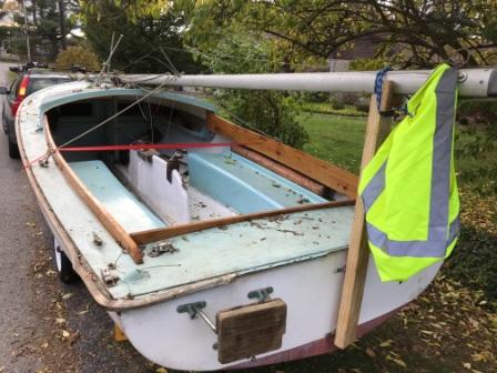

Get a pair of pintles (those are the pins on the rudder that hook into to gudgeons). Mount them on a board that is about 3' long (a simple 1x4 will do for this). Notch a Y at the top.
Hook that into the gudgeons as support. Works for trailering as well as to get the mast level for raising it.
(There's no need for using really massive lumber, even a 2x4 is overkill, but if you'd like to use it as part of your winter storage, then seal it in epoxy and paint/varnish it against UV).

I have a support like GreenLake described at the transom. The forward end of the mast rests on a U-shaped bracket at the top of the winch post (which is fairly long). I've got about 4000 miles of trailering with this setup and haven't had any apparent problems.

In addition to the two support points as described by Alan, I have a third support at the mast partners. With a keel-stepped mast, I can insert a mast support there, so my mast ends up supported in three places.

I purchased two pintles on eBay (intended for a Hobie) for about $20 min the Fall of 2019. The two pintles fit perfectly into the gudgeons on (used by the Day Sailer rudder) already attached to the transom. I used a 4 foot 2x4. I have attached a picture of the mast support in the back of my Day Sailer. You should use some sort of stainless steel safety pin like device to prevent the pintle from "jumping" out of the gudgeons when the boat is being trailered.

Good point about the pin. One of my pintles has a small hole in it for a pin. GL, I think you have another type of security device to keep your pintles in the gudgeons, but I can't remember what it is?

For keeping the pintles in the gudgeons while on the water, I have two devices. On L bracket that can rotate out of the way to allow the rudder to be removed and one SS strip, bent so that that forms a shallow V with the rudder head, with the tip resting against the pintle. It has to be pushed in towards the rudder head to allow the gudgeon to slide along the pintle.
For trailering, I do not rely on either of these. I tie a line from stern cleat to stern cleat, with one turn around the mast. I also duplicate that with a long bungee. The line ensures that the mast support can't jump out, and the bungee makes sure the whole thing doesn't continually bounce while on the road (there's always a small amount of slack in the line that would allow play).
Further: I strap the mast to the mast support with a PU loop (or short bungee) attached to a screw on either side of the support. I don't mind the extra minute strapping things down even for a short haul. Peace of mind.

Pintles are fairly generic, the main differences are diameter and the type of connection: some have a flat strap and are designed to be attached pointing upwards on a transom, some have U shaped straps that are meant to go around a rudder head (they can be screwed in, or through-bolted, depending on how the hole patterns line up). Those are mounted facing down on the rudder head.
For the mast support you want the former, but mount them pointing down on the support. For a replacement rudder, you want the latter. Just be sure that the pin diameter matches and (for a rudder) that the U is wide enough to fit your rudder head.
