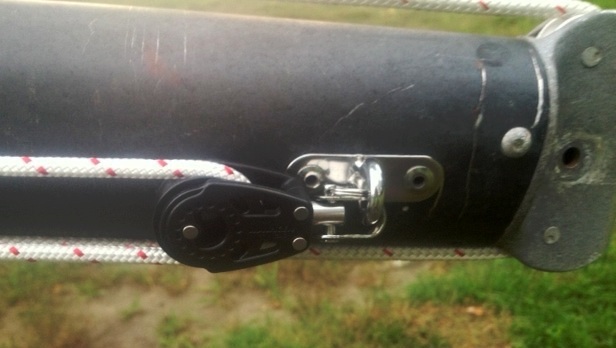

The transformation... Always moving forward. Last week I posted about our first time sailing on Lake Webster, $50 bucks to use the ramp but thats another story. We had great air. With inexperience anything can happen. Leaving it at this... We broke the boom crutch/support. I never really liked the way it worked, nor did my wife who had the boom drop on her more than once. It also seemed to get in my way of other things, no matter where I put it. So with this our topping lift was born. The picture is the setup on the port side of the mast. The line runs down to a halyard shackle that I attach to he rear most hole on the boom. The other end is made up to a cleat that I attached to the same side of the mast about a foot up from the other cleats that control the main and jib halyards. When the main sail is up, the pressure is off the topping lift and I undo the shackle.

Topping lift hardware

I never tried the boom crunch, but use my topping lift all the time.
