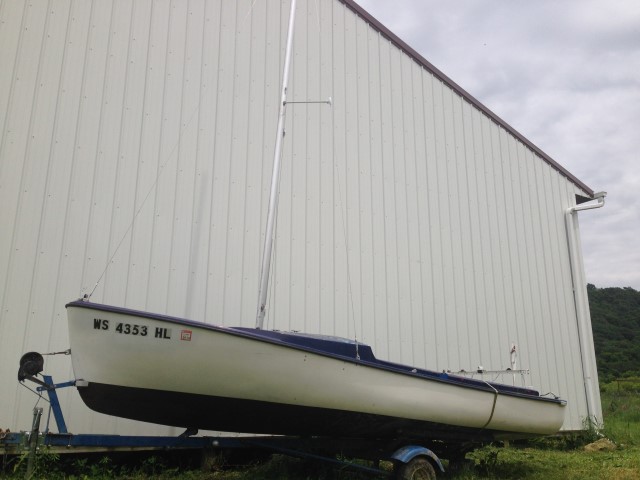

Rudy from D&R was very helpful and hooked me up with new stays, rubber spreader boots, and a windex. Just got the stays on today and they fit right. So excited.

You know the boats been waiting too long when just mowing the grass around it feels like a big step!
With the full-sized turnbuckles, do people put a screwdriver through them or something to get better turning leverage?
Just ordered trailer hitch for my wagon and will arrange a meetup with a local daysailer club guy to get me ready for the water soon. And then it's paint time. Thanks for all the help Greenlake.

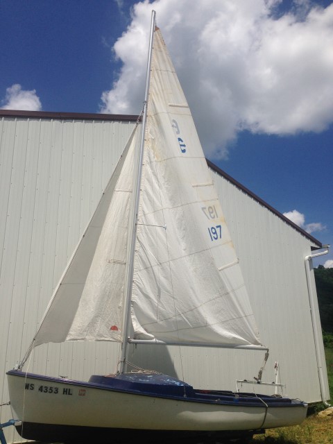

Sooooo close. Wife and I raised the main and jib today (or at least the best we could having never done so before.) Turns out the outhaul line was already attached to the main and there was a cleat and a loop to wind it through so that was self-explanatory. Not sure I got the sail tensioning right, but I can show that to my local guy and see what he says. Also grabbed a random piece of rope in the bag and hooked up the traveler. As you can see, the guy who sold the boat to the guy who sold it to me made a custom piece of equipment to moderate traveler...travel. heh. At least, I think that's what it's for.
My only concern now is that the lower batten in the jib is snapped in half, and the battens appear to be completely enclosed in the sail. Is it normal to have to remove stitches to remove a batten? Is that something a layman can do? Is it dangerous to the jib to try to sail with the bad batten?
Oh, also, my wife especially whether the jib sheets go straight from the clew to the blocks on either side of the boat and then to the cam action cleats next to those blocks, or whether those sheets go through the two blocks on either side of the base of the mast.

The whole point of a traveler is that you can adjust its position laterally, changing the direction the mainsheet pulls on the boom. Having the traveler this far back reduces the angle over which it is effective, but it should allow you to fine tune things for upwind work up to a close reach, I'd think.
The jib sheets do not pass the base of the mast. They normally go to track mounted fairleads or blocks at the forward end of the cockpit. They are on tracks so that you can adjust the angle of pull until the sail "breaks evenly over the entire length of the luff". Translated that means, when you come into the wind, both top and bottom of your sail should stall (begin to flutter at the luff) at the same time. If not, move track forward or back to adjust.

If you don't have jib tracks, that would be a bit surprising given that previous owners installed a custom traveler, but you never know.

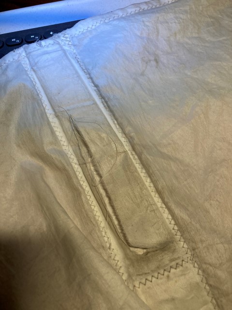

Insert and re-stitch with polyester thread (the clear stuff) or fishing line, or some strands from an old polyester rope. Whatever you have at hand. Don't stress about having a sailmaker's needle, palm and all the other stuff.
So...funnily enough, this broken batten in my jib finally ripped through the batten pocket, and when I was searching these forums about what needle and thread to use, I found my own post that I'd forgotten about. I already ordered some 4 oz dacron, although I also have Tear Aid Type A patches big enough to fit the (mainly horizontal, but also vertical) rip. I'm wondering if fishing line is still okay to use, because unlike sewing closed the end of the batten pocket, I can't just do an easy 1.5" whipstitch -- the rip I have is about 7" long and will require a patch over most of the batten pocket.
