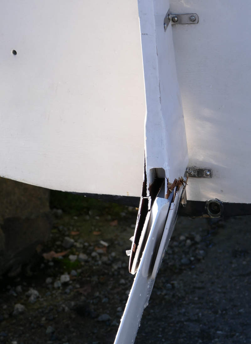

Latest data item: collision with a keelboat. They failed to duck me and hit the stern quarter of the DS. Other than some lighter spots on the rub-rail, no visible evidence of the collision --- except for the rudder.
The rudder didn't like the sudden sideways motion through the water, and the cheeks of the rudder head proved to be the sacrificial part. It wasn't a clean break. On the side towards the impact, the plywood for the cheeks failed and it delaminated, but there was enough there, or in the thin glass sheath to prevent the rudder head from separating.
The opposite side, away from the collision, broke cleanly in a pretty straight line. Wood and glass.
The rudder blade looks undamaged, and no damage to the pintles or gudgeons.
I'm not sure what to think. If allowing the rudder to break, allowed the stern to accelerate faster and thus take no damage, that would be a plus. On the other hand. if the rudder head can break before the gudgeons are bent, even a little, it might indicate that it broke a bit too easy.
Tentative plan is to switch all or part of the "cheeks" to fiberglass this round. But it won't be a controlled experiment, as I'm not planning on being rammed again. :shock:

Rudder damage; click on image to view all
This photo clearly shows how the boat was shoved from port side and the water kept the rudder in place. The other boat never touched the rudder itself. One of the two cheeks that hold the rudder blade simply tore clean across under tension. The other delaminated inside the plywood.
After taking it apart and looking at the wood, it appeared discolored, so it looks like water had gotten in at one point. Both the outside painted surface, as well as the inside were covered with a glass sheath. Except at the break itself, these surfaces are undamaged, unlike the interior of the plywood.
Because both rudder head and blade are undamaged, my plan will be to replace the cheeks (and beef them up a bit in the process). Anybody interested in using the information here to build their own rudder might want to take similar steps for a somewhat stronger design.
Note that the original design of the rudder did survive over a decade of use, something that hopefully means the repaired one will last even longer.
