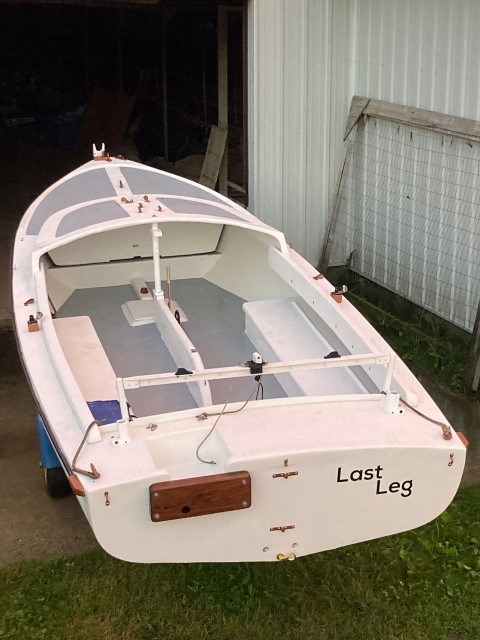

Done!
I ended up building a motor "bracket" out of 2 layers of glued-together 1.25" black walnut, as we have a lot of it on the farm. Epoxied/fiberglassed it for extra strength, and through bolted it to the transom. It's at the right height where I can both use the handle to steer, turn it around for reverse, and the cav plate is roughly equal with the hull line below it.
For some reason, when I painted the EZ-deck on the floor and non-skid deck portions, I had tons of paint intrusion under the masking tape. I used that blue "sharp lines" 3m tape. I didn't have that problem in other areas, so I'm wondering if maybe when I solvent cleaned maybe I got too much solvent on the tape or something? It was pretty universally everywhere too..which is a bummer, but, just cosmetic so no biggy. Overall I'm really happy. Going to take it out on a local pond first to make sure we remember how to rig it and the centerboard deploys, then off to our version of a "lake" - a chunky part of the Mississippi called Lake Onalaska. Thanks for much for the help everyone, and especially Greenlake.
last leg final (Small).jpg (75.46 KiB) Viewed 713775 times
marcusg
Posts: 138
Re: Basic Painting Questions
Postby GreenLake » Tue Jul 05, 2022 9:55 pm
Looks fantastic!
(Don't have a clue on the paint intrusion, but if you washed the edges of your tape then perhaps all bets are off?)
Posts: 7309

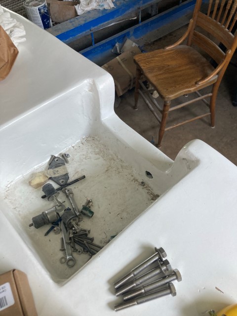

Question for here: I took notice of this exposed wood on the interior aspect of the transom which seems be there to reinforce the two brackets which hold the posts of the Rudder. The wood is partly exposed and has other sections that are well covered. Currently exposed aspect should not be exposed to standing water. Should i do more than coat this well in paint? Lazy part of me would like to leave it at that, but I'd like to protect the wood and avoid bigger problems in the future. Currently everywhere I knock on the wood is firm/I'm not detecting any rot.
Thanks for any advice!
thoughtfulreef
Posts: 8
Joined: Wed Jul 20, 2022 3:43 am
Postby GreenLake » Thu Jun 01, 2023 7:12 pm
Pettit EZ-Poxy can be very durable, but you need to give it time (!) to cure. Also, you should thin it, as suggested as unthinned it forms a thick film that takes even longer to cure and will stay soft. Several thin coats with the interval stated in the directions are your key to success.
As to exposure to standing water, I have no experience. If your hull has a drain, be sure it's open if the boat is stored where rain can get at it. (Tarps are not foolproof). As you are fairly committed at this point, no sense doing anything but completing the job.
Exposed wood: it's hard to see, but if you really have bare wood, then either leave it as is (until it fails), or remove it completely, make sure it's dry, coat it on all 6 sides and on the inside of each screw hole with Laminating Epoxy or an epoxy product like SystemThree's Clear Coat. That will seal out moisture. I would use one layer of the lightest glass cloth on the side facing the cockpit as a guard against anything bumping and penetrating the seal. After that, you'd paint it as normal. Also for UV protection.
If that's done correctly, the wood should stay sealed and dry. Optionally, you could apply something like BoardDefense which suppresses any undetected rot or dry rot from spreading. But you can't have any voids or uncoated sides, as moisture then can wick in, but not dry out. This method would be most preferable if you expect standing water.
Alternatively, if you can't remove it, you might treat it as above, but then coat it with some wood oil product, preferably something that can be reapplied without having to take the old coat off. That would not prevent moisture in the air from getting in, but would protect it from splashes and short exposures. But, being only a partial seal, it would allow it to dry out (slowly), when the boat is not being used.
