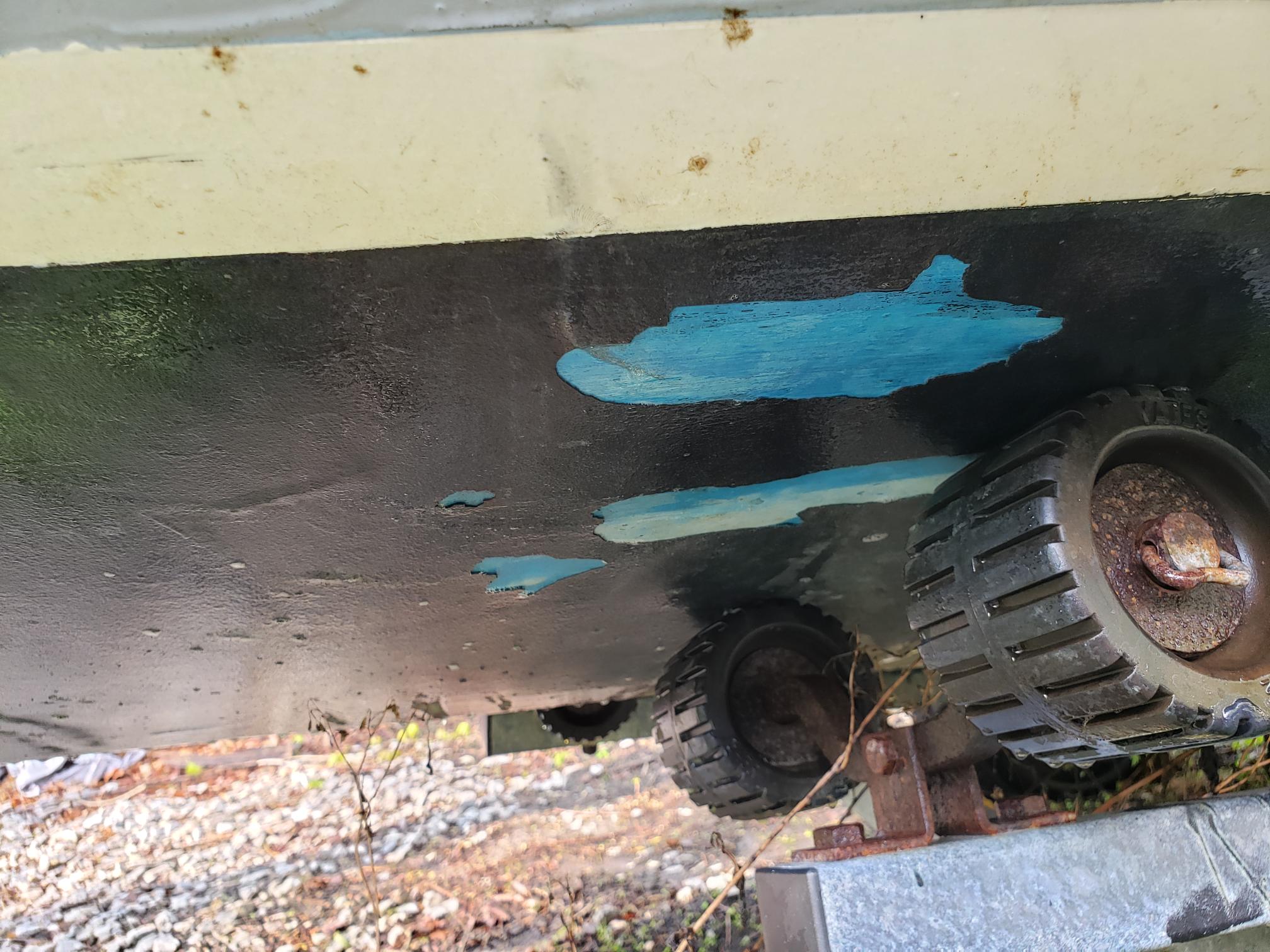

I uncovered and was going about washing the daysailer II with plans to get it in the water this week.
I noticed the underside has paint coming off..
I honestly don't know what the normal technique of painting the bottom is so can't really diagnose best action.
I am assuming and hoping, its an additional layer and not something more disturbing.
The hull flexes slightly where it sits on the wheels on the trailer.
Again, an assumption and hope that this is fine..I have been sailing it all last summer with no issues and it performs great.
Obviously I am not going to get my best speed like this. But can I get away with it and repair the patches, with advice on best technique appreciated, or am I looking at having to do the entire bottom ??

First. Do you keep your DS on a mooring or in a slip? Then you want some antifouling paint and that does look like it might be something like that.
Second, if you like to sail your DS, you won't be happy with a paint job that is that rough and / or flakes off.
AF paint is intended to be reapplied periodically, the interval depends on the type. This one looks like it's failing and should be scraped off. Whether you put new AF paint on your boat depends on how you use it. If it lives "on top" of a dock, instead of "next to one" or if it lives on a trailer, then the boat is being "dry sailed" and you can use a variety of paints that don't normally like being submerged. Those tend to have a 24h, 48h or 72h window, which is generous for the typical daysail and might work for a short overnight cruise. (If you pull your boat fully on the beach overnight while cruising, you should be able to push that window a bit longer).
If you do apply AF paint, try to find one that goes on smooth, or, if you can, talk to sailors in the same waters for recommendations, because different brands/types work differently depending on local marine growth (and some waters may have their own regulations).

Its on a lake, previously was on the long Island sound.
Should I scrape and repaint the patches, or redo the entire bottom ?

From the images it looks like bothe the black and the gray paint have failed. Normally that means full removal. The DS isn't that large so the total bottom surface isn't much more than a few dozen square feet.
But you could leave the gray painted area for the fall.
I don't have direct experience with anti fouling paint (if that's what's currently on your boat). So I can't advise you on what you need for your lake. From reading online, if you keep your boaton the trailer in the winter, you would be looking at ablative AF paint.
You may want to do an Internet search for recommendations for freshwater use. Make sure whatever info you get is recent as AF paints tend to get reformulated to reduce environmental impacts.
Whatever your choice, it should be smooth after application or you'll be sailing with the parking brake on.
The kind of rollers you have on your trailer are a poor choice for the DS as the wheels create point loads that flex the hull.

Postby Quiggers73 » Tue May 06, 2025 4:29 pm
Totally agree on the rollers on the trailer. Never made me feel comfortable.
But the trailer is more expensive to replace than what I paid for the boat.
Would the best action be to take the boat off the trailer and tip it on its side ?
Do I lean it against the mast while doing this, or as the mast is down is there a better way ?

Postby GreenLake » Wed May 07, 2025 3:43 pm
You can tip your boat on its side as described here, the force on the mast to keep the boat in place is very small, due to the long lever arm. Works well if you have the space and easy to do on your own.
You may find it easier to work on each half of the hull separately, and reposition the boat in between so each one can be the upper half. Season to taste.
Or you can take the mast off, use 2-3 people to tip it, then tip it onto some supports (old tires?) that prevent point loads on the cuddy deck. You can have your helpers lift front and back in turn and build up your supports a bit to reach working height.
When "launching" your boat on the hard, an old bit of carpet comes in handy.
