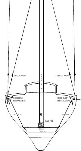

There's of course no end to making the DS more stiff - I recently came across a nice discussion of ribs and stringers for powerboats - those go up along the side of the hull - so if the current project doesn't leave you with the stiffest boat on the circuit, there are more extreme things you can do next. :D

Phill wrote:If you look at the final picture, you can also see where I added a half round (paper towel tube) stiffener that runs through the Centerboard pivot vertically on both sides. My thoughts were that with the thwart boards supporting the trunk from sideways movement were adding support in the wrong place. So I added these tubes (matt glassed) to dampen the side to side torque of the CB top when sailing.
Phill,
I guess the fact that I took this long to reply to your post should show you how puzzled I was and still am about these CB stiffeners of yours.
The thwarts prevent the hull from changing width - in addition, they prevent the CB trunk as a whole from moving sideways. Being placed high on the trunk gives them good leverage for that second task - if the trunk is stiff enough.
So, what's left? Did you observe bulging of the CB trunk walls from sideways movement of the CB? That wasn't clear to me from your description - in that case the reinforcements make some sense. If you were concerned about twisting forces on the whole trunk, I would doubt that your tubes are effective.
[Personally, I've not observed that (haven't really watched for it either) but I also no stress lines on the CB trunk.]
So can you be more precise - what did you observe? Which motion, bulging or twisting, did you attempt to address?
