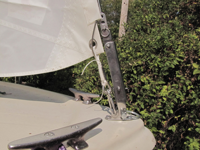

I have a roller furler on my Doyle UPS headsail. That's out of necessity, because it's too big to tack within the foretriangle, but I absolutely love it. I've also got one that I plan to install on my regular jib.
I should note that I'm barely past the rookie stage when it comes to sailing a Daysailer, and more skilled sailors might well tell you that roller furling is expensive, complicated, and most likely to fail just when you need it most. I heard that last one from a guy who gave me lessons in a Hobie 33, and I've got a world of respect for him. There's a lot to be said for the simplicity of a jib downhaul if you need to shorten sail in a hurry.
However, there's also a lot to be said for roller furling, as I think you agree.
And now you've got me tempted. I have an Intensity jib, maybe half a year old. I THINK it will accommodate a roller furler, but I need to find out. So, somewhere in the next few days, I need to rig the boat, install the roller furler, and see what happens. Among other things, I need to adjust the multiple windings of string (Talbot, we need the proper jargon here) that connect the jib tack grommet to the same thimble that the luff wire is connected to.
Intensity jib tack.jpg (137.21 KiB) Viewed 10262 times
I think the luff wire will support roller furling, but the way it's set up now, the fabric of the sail will take all of the load. Probably not good.
