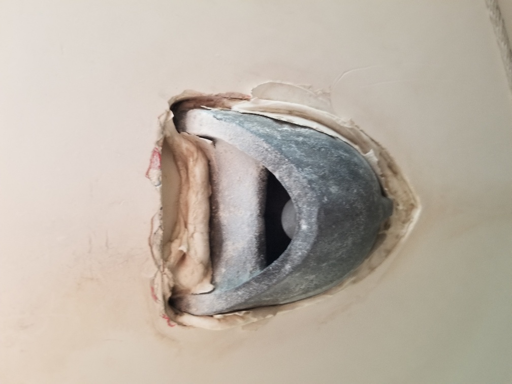

Also while the boat was on its side, I noticed a poor maintenance job from the previous owner on the auto bailer for the bilge.
Bilge bailer.jpg (140.03 KiB) Viewed 3776 times
The stuff looks and feels like silicone bathroom caulking. I already purchased some 3M 5200 to fix the same caulking issue under the transom lip but it sounds like that would be a poor choice on this part, as it should be replaceable. Any suggestions on a product to reseal this after I remove all of that silicone garbage?

A "thin crack" that you can hardly see at the top(!) of the CB trunk doesn't sound like an issue worth worrying about. Given the location it would be near impossible to get at and it is not unlikely that it is simply a crack in the gelcoat.
For the bailer you are looking for something other than 3M 5200.
There's a magazine called "Practical Sailor" that is like a Consumer's Report for lots of sailing-related gear and materials. They ran a test on sealants and recommended Sika 291 or Loctite Marine. Both suitable even if you leave your boat on a mooring for the season.
