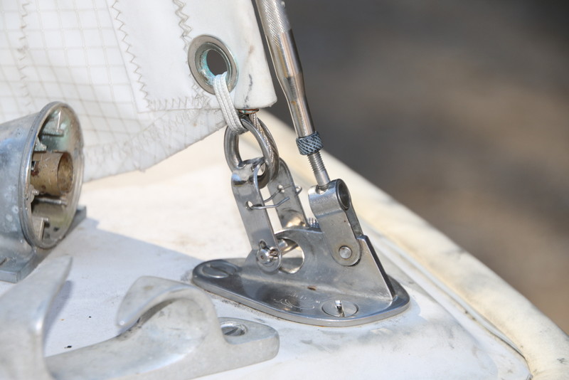

The tack would attach to the deck, but the first hank does not have to be at tack level, or does it?

I think not as the shackle is what holds the sail to the stemhead, 1st hank is about 14 in above that.

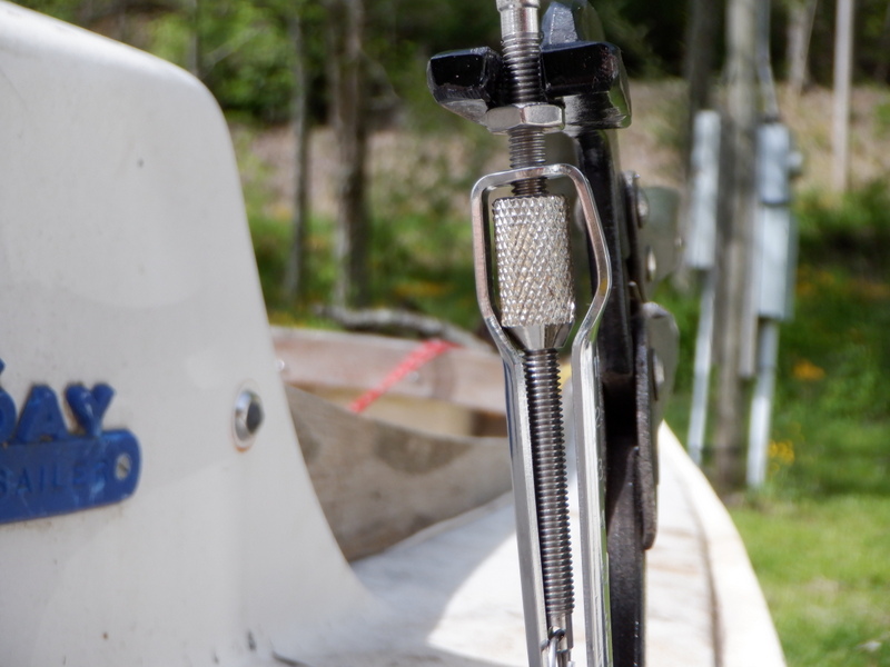

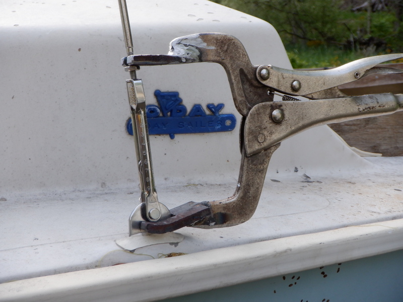

what I did was go back to the original foot location (actually 3/4 in more aft. It looks good, I have about 90lbs on the forestay, 150 lbs on the side stays, I took one of my welding vicegrips and modified it so i could take the pressure off the adjusting screw so I could add or remove tension, this was done with a Loos gauge on the stay. worked out great, not bad for 30 min of construction time.

I've mentioned that I like to putter and make things :P . To adjust the tension on the stays i would have to disconnect the fore stay so it would release the pressure on the turn buckles, this way i dont have to, this releases the pressure just enough to be able to turn the knurled screw that adjust the tension.
it worked better than i thought it would. stays are 1/8 from D&R with standard turnbuckles.

Garry, there's a misunderstanding here somewhere. The first hank is not at the clew. So it (the first hank) can be a few inches above the deck w/o the foot of the jib having to also be that high.

There's a benefit to a "decksweeper" jib: it cuts down on or eliminates pressure equalization across the foot of the sail, making the bottom portion of the sail more efficient.
