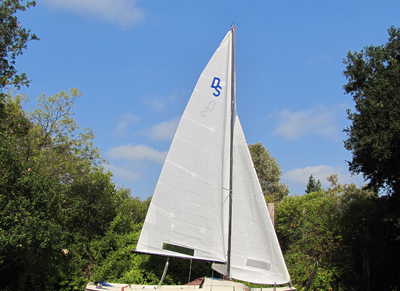

I did a test fit of the sails this morning. Yep, they're for the right boat.
The second photo shows the main not quite all the way to the top of the mast, despite vigorous tugging on the halyard. I'm wondering if the splice is to big to fit in the sheave - something to be checked once I lower the mast.

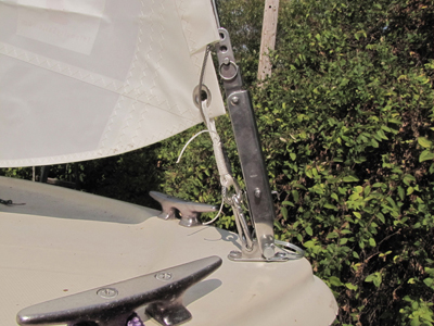

The third photo shows the jib tack. I can get the luff tight, but not the luff wire. I hate to unwind and extend that fancy-looking link, and maybe it's something you're not supposed to do. I seem to recall that there's a recent thread on a similar topic - maybe the answer is there.

GreenLake,
You posted this on the "Jib tack question" thread (boldface my additions):
"Re: Jib Tack question
Postby GreenLake » Tue Jul 16, 2013 9:55 pm
I'm not able to take a look right now, but my Jotz sail came with that configuration (minus the bronze shackle).
The halyard tensions the luff wire. The luff tension (in the cloth) is adjustable by pull on the grommet. The lashings would provide a maximum distance between tack and deck, hence defining a minimum tension in the luff. The shackle looks like it can / could be connected to some kind of downhaul for additional control.
I haven't ever seen the need to try and play with these options, and, if I recall my discussion with Hank Jotz at the time correctly, he essentially intimated that if the lashing he put on were to be the wrong length for my forestay, I was to adjust it once."
Sounds to me like I've got the arrangement you describe there, and that I should loosen the lashing, get the luff wire tight, then tighten the lashing to tighten the cloth at the luff. Does that make sense to you?

Postby GreenLake » Sat Aug 10, 2013 3:03 am
Guess so. As I wrote, I never needed to adjust those.

It suddenly occurred to me to contact Intensity Sails and ask them about adjusting the lashing. It can be adjusted. I think I'd better do that, otherwise the fabric will be taking all of the strain with no help from the wire.

Regarding the main, it does appear that the halyard won't fit through the sheave at the top of the mast. You might try cutting the halyard at the eyesplice and simply tying the shackle on with a bowline. You could also keep the splice, and use the downhaul to tension the luff. The only problem with that is the boom might end up too low. One of the design features George O'Day insisted on in the DS was a boom that would clear the heads of the crew. Another consideration is racing, where the height of the boom is specified by rule.

Postby GreenLake » Tue Aug 27, 2013 9:45 pm
An eyesplice can indeed be too bulky. Exacerbated by the fact that many DS sailors overdimension their running rigging. :)
A splice, with shackle, is not the shortest possible connection, especially if much of the splice can't fit the sheaves.
A bowline isn't necessarily the best alternative. Because it can't be cinched after it's tied, its fixed loop is often longer than necessary.
A buntline hitch (google for tying instructions) has the advantage that it cinches up and therefore represents the smallest possible loop. It was invented for being tied to a flogging part of the sail and won't come loose. In modern rope, it is easy enough to undo it after it's been loaded. I used that for a number of years for my jib.
Another method is a toggle at the end of the halyard. A bight is pushed through the cringle and the toggle (or large knot, e.g. diamond knot) is brought from one side of the headboard to the other and trapped by the bight. This connection adds at most a single rope diameter in length and is trivial to tie and undo.
I'm currently using a soft shackle based on the excellent instructions on http://l-36.com. I tied a short end around the cringle using a cow hitch and finishing in a large knot (diamond knot). The soft shackle is a special eye splice with an eye that can be worked open and will pull tight under load (easy with Dyneema). The halyard gets connected to the toggle by opening the eye and placing it around the knot. That gives a reasonably short connection which is quick to connect - a little bit slower than a metal shackle, but not by much.
As a Dyneema halyard can use a smaller diameter, the eyesplice will fit the sheaves.
I enjoyed the splicing work in that setup, but I'm thinking that the toggle at the end of the halyard is the best approach. Instead of a fancy knot, just use one of those terminating balls.
