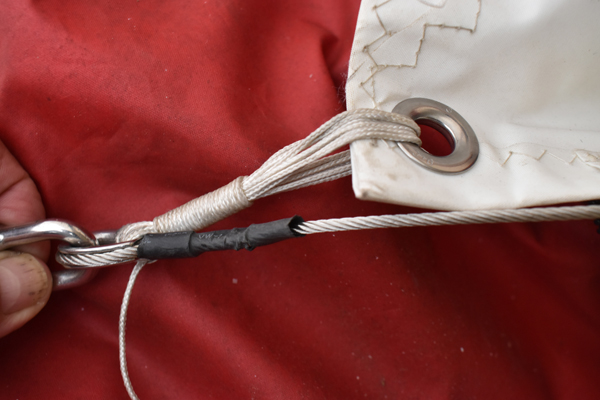

Postby Alan » Thu Mar 03, 2022 5:08 pm
jib tack luff wire and lashing resized.jpg (168.18 KiB) Viewed 21324 times
GreenLake,
is this the sort of lashing you're talking about? This is what came with my Intensity Sails jib. I had to adjust it when I first got the sail, and it took a while.
Posts: 761
Re: jib luff wire question
Postby GreenLake » Fri Mar 04, 2022 3:27 pm
@Alan: Nice picture. That's what this looks like on my sail.
