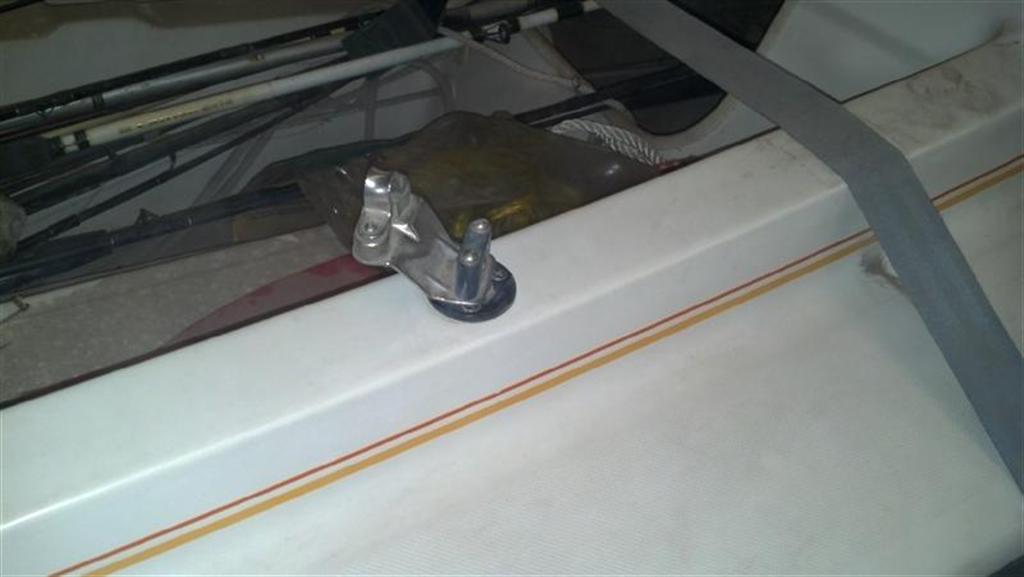

Mine look like this.Their original. there seems to be a wide variety.
jibsheetcleat (Medium) (Large).jpg (52.07 KiB) Viewed 13302 times

OK I admit I was just trying to see if I was smart enough to put a picture on the site.. But I do wonder how they come about to have so many different kinds.
