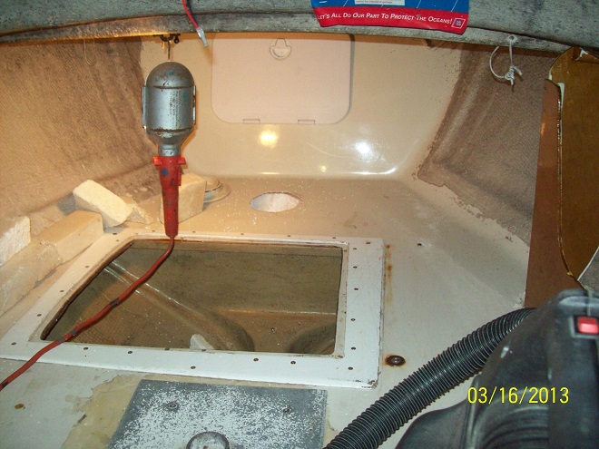

I have added another hatch to allow stowage forward of my mast. Shows that low bulkhead under cuddy floor.
View of some of my access to bilge in cuddy_b.jpg (185.63 KiB) Viewed 16045 times
If installing more inspection ports to aid access and drying out the bilge areas, a few tips may help!

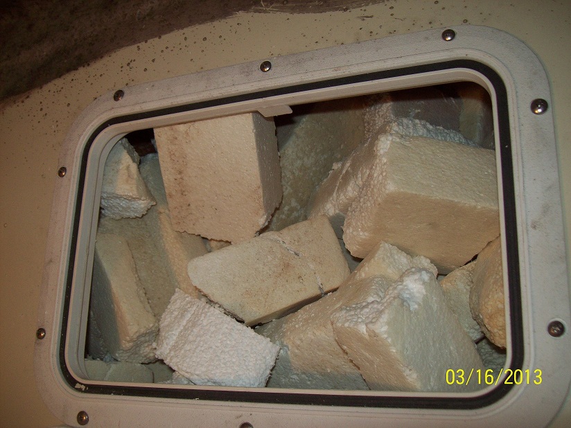

The bulkhead in the bow area, not a bad idea to have an inspection port there to be able to access the bow eye and the bow cleats and forestay fitting bolts, however, unless you are more flexible than I am, I'd get a small access hatch (about 9" x 11") instead. That will allow getting an arm in there while still being able to see what you are doing. The whole compartment forward of that bulkhead is full of small Styrofoam scraps (flotation) not hard to pull out if needed to gain access, just tedious! There is more of that scrap foam for flotation under the cuddy inside decking (floor), it is between the bow compartment and a low bulkhead under the cuddy floor located about 18" or so aft of the forward bulkhead. That area actually contains larger foam chunks which may get in the way of real access to the bilge, I added an inspection port there to be able to dry out the area if needed. Basically, aft of that low bulkhead under the cuddy floor, the bilge is empty except for foam blocks bonded up under the seats in the cockpit. You should be able to bail out 90% or more of any water in the bilge through the two inspection/bailing ports at the forward end of the cockpit. If your boat is a 1979 or older that is also where you access the bolt that holds the centerboard pivot in place (use a 3/4" wrench to tighten the bolt). A warm, sunny day with the two inspection/bailing ports open will usually dry out the other 10% of the water that may be in the bilge. If my bilge is "damp" after a morning sail (any water that I couldn't reach with a sponge when bailing or what might have been in some obscure little pocket of the bilge), I tend to leave those ports open while I go in for lunch, on a typical Summer day, the bilge is dry an hour or 2 later!
OH, and if anyone wonders what O'DAY used to do with the Styrofoam packing chunks that must have come packed around various pieces of equipment for their boats........... just look in the bow compartment of your DS II!

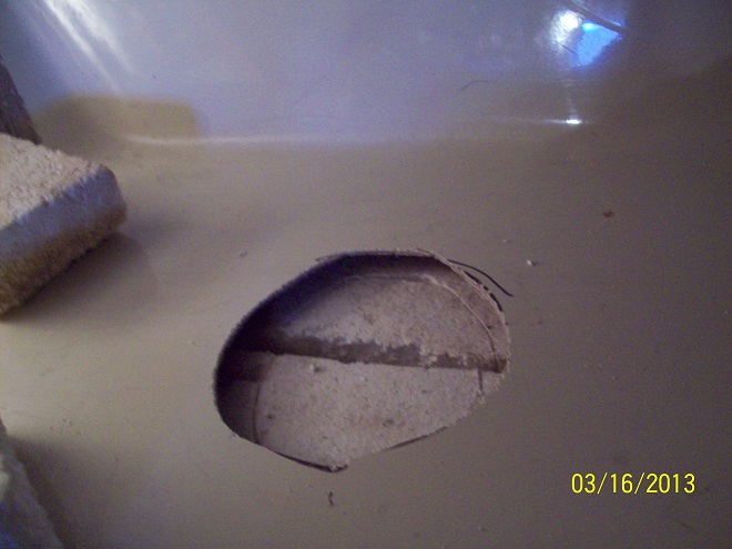

Before I cut a tunnel in the foam
Inspection port aft of forward bulkhead in cuddy_1a.jpg (136.79 KiB) Viewed 16045 times
Forward bulkhead hatch_and foam chunks_a.jpg (248.24 KiB) Viewed 16045 times
