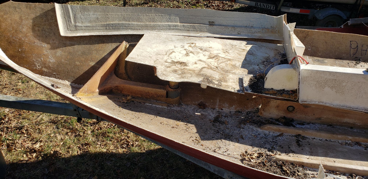

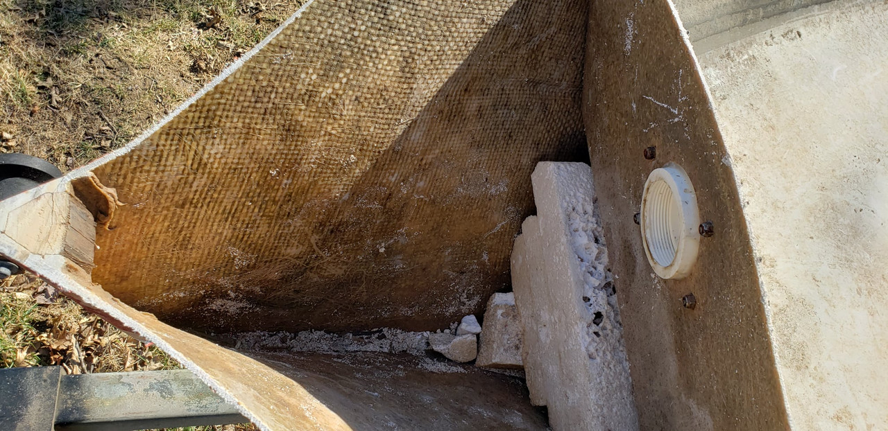

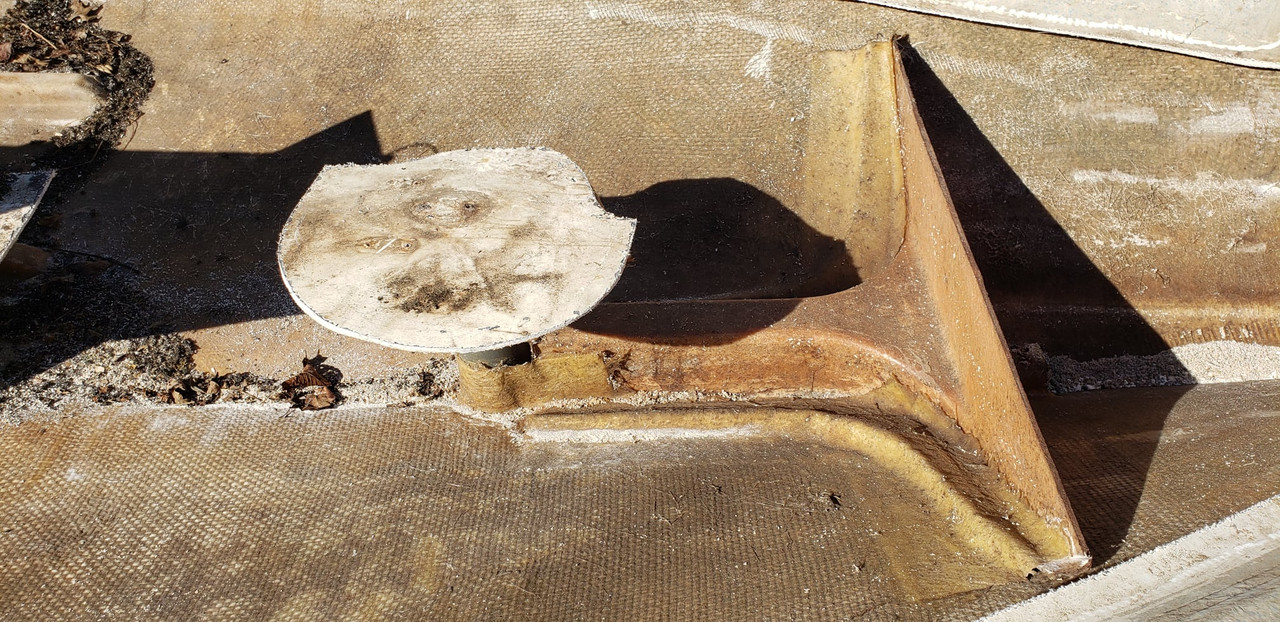

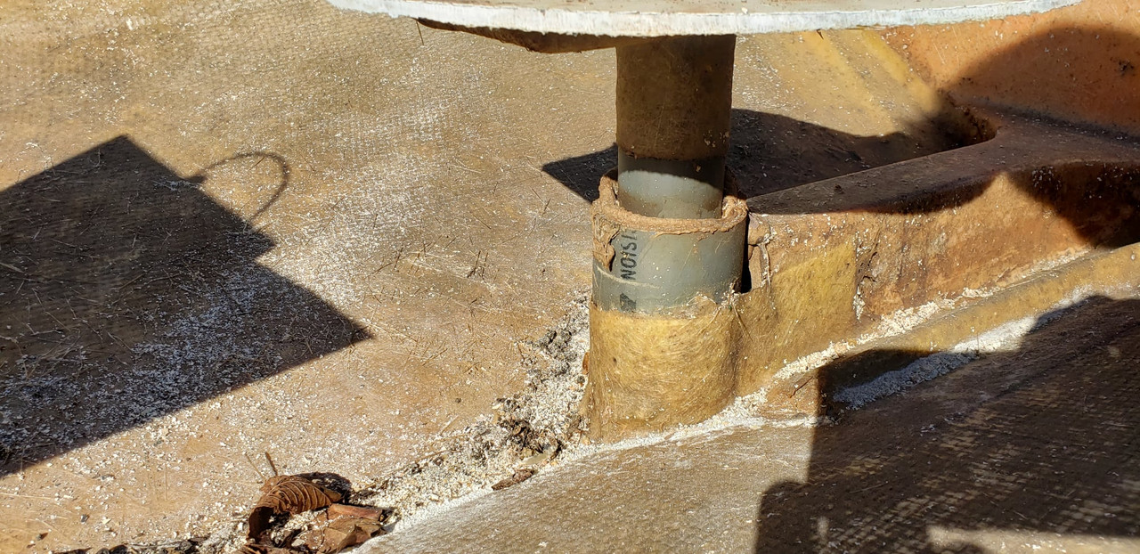

Here are some pictures I collected of a recently cut up DS2. Pretty simple really. I don't know why you would want to cut in front of the post into the floor. The first picture is viewed from the front and would be the front wall of the front triangle area where most boats have an access thru hole now. Second is the same area from the side. Third is the mast base under the cuddy floor. Looks like some kind of old ABS type pipe to me.

Alan I'll have to respectfully disagree on my pics and your thread link pics. Just like in my boat the fore area in front of the cuddy goes back under the cuddy floor for about 16 inches. That under cuddy in front of the wall area in mine is full of 3"x6" cut Styrofoam pieces running cross boat likely installed at the factory. They are in there tight and mine are fairly dry so I left them in there to maintain a "wall" between the front void area and the under cuddy void area.
Unless those other thread posters include a picture from the front showing another more forward wall then the boats are near the same in construction in my opinion. There just isn't that much area for another box if you look at the bottom picture in my post above. In that picture you can clearly see where the fore area comes down and them tucks back under the cuddy floor. A person could use a tape measure or long scale to work out the wall placements.
I can see the foam in my camera views from the front and the rear. There is no "box" but a fiberglass wall is indeed there. Even the pictures in the other thread visibly have foam just over the top of the fiberglass wall. That wall looks to me to even possibly be a leftover from the DS1 design as the 1 does have an enclosed bow area which creates a shelf like area in the front. I'm only going off pictures I've seen of DS1's as I haven't seen under one personally.
I'll upload more pictures showing the cut up boat of how the foam lays cross ways in front of a wall. My boat is the same and has that area of flat cross ways foam. If those foam pieces are 4" thick then it would be about 20" of under area going aft from the front most area (forward cuddy wall). The second picture is before the forward cuddy wall was cut out.
