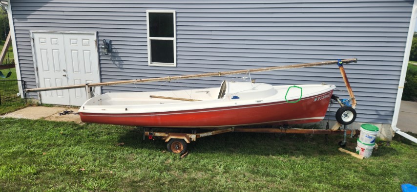

I recently bought a 1976 Day Sailer II (#8098). I've been reading the forums and I can't see any other boat with this hole. Should I fill it? It seems like it just lets water into the bilge.

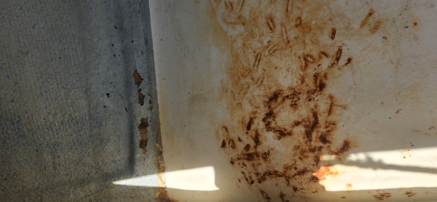

Thirdly, does anyone know a good product for removing rust stains from inside the cubbie? Previous owner left a rusty anchor chain in there for a couple years it seems.

Rust stain: Bar Keepers Friend. Like many similar products it's also a light abrasive, but on the cuddy floor that shouldn't be a concern. Anytime you need to restore gloss to gelcoat: 3M Finesse It II (can also be used to restore CD's should you still be using them).

Superfluous hole: if in doubt, a square of the 2" wide electrical tape will probably seal it quite well, but remains removable. If not in doubt, filling it should be fine. I take it that you do have a way to drain your cockpit?

I own a 74 DSII and can’t say I’ve come across such a cockpit hole before.

BKF worked great on the rust spot.
