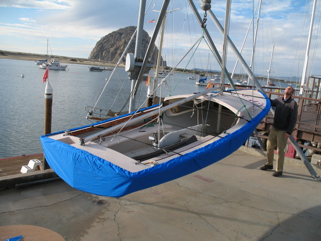

I happened upon this photo on the internet of a DaySailer being hoisted by three points. It might give you better idea where to start with yours.
If you'll be hoisting your boat a lot, it may be worthwhile to install dedicated lifting points like in the photo. I wouldn't trust the stock deck cleats, even with reinforcements. The aft port corner of the deck on my boat had separated from the hull. I happened to find about it when I pulled up on the cleat and deck moved with it. I've since repaired it with 5400 marine adhesive, but still I wouldn't want to lift the boat from that location.
