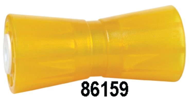

@badgley, I may have - I've had so many failed retrievals before I made that change that i "got religion" when it comes to starting with a roller like this:
(found here: https://www.fisheriessupply.com/tie-down-engineering-poly-vinyl-keel-rollers-keel-roller).
The groove may be even deeper on mine; it does provide a nice "pivot" point once the first foot or so of keel is past the roller, pulling on the rope will straighten out the boat. Without a groove, there's a tendency for the keel to simply roll at an angle, rolling right off the roller.
